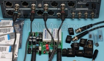

                          Väga asjalik artikkel – kinnitab ka minu mürade mõõtetulemusi ja kogemusi. Bipolarsisendiga Op kasutatakse madalamatel sisendtakistustel ja FET kõrgemaoomiliste puhul. Sama kehtib ka erinevat tüüpi transistorite mürade puhul. OP andmelehel tasub vaadata pinge- ja voolumürade väärtusi. Selle järgi saab otsustada, milliste sisendahelate takistustega antud OP sobib, et tagada min mürad. Ka ei ole mõtet omavahel eri tüüpe (FET ja bipolaar OP) skeemides asendada - tulemus on üldjuhul kehvem! Kui takistused ei sobi, ei pruugi isegi 100X kallim OP tagada asendusel väiksemat müra – tulemus võib olla vastupidine. Suuremat rõhku tuleb panna ka muudele sisendahelate detailide müradele, eriti kõrgemaoomiliste ahelate puhul.
                          * The NE5532, as mentioned in the last article, was originally developed by Signetics mainly for audio use. At the time it, for audio applications, it was like comparing a modern day Ferrari to an old Volkswagen Beetle. It really wasn’t until the LM4562 (see above) came along there was much reason to use anything else for most consumer audio applications—especially if you exclude microphone and phono preamps. There are op amps with better DC specs, faster settling times, higher slew rates, lower offsets, etc. But none of those improvements help 99% of audio gear perform any better. And those “partly better” parts are often worse in more critical areas. The 5532 is the corner stone of nearly all high-end professional audio gear which means most of your music has already been well steeped in 5532 goodness. If you dislike the “sound” of 5532 that means you must also dislike most of the music available.
                          *TL071/TL072 – These were mainstream audio parts and used in lots of pro gear before the 5532 came along. For all those speed freaks, it’s worth noting they’re rated only slightly slower than the elite chips at 15 V/uS. They were also among the first reasonably priced FET op amps that were useful for high quality audio. But they suffer from very limited output current, they can’t get very close to the rails, have higher distortion, and they’re relatively noisy. Their lower power cousins the TL061/TL062, and the lower spec TL081/TL082 are even worse.
                          THD+N - vaata ka allpool olevaid graafikuid:
                          INTRO: In last week’s Op Amps: Myths & Facts article I covered the background for op amps, why they’re important, and some common audiophi...
