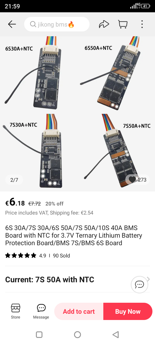

              Tellisin sellise, 50A, termosensoriga Click image for larger version
