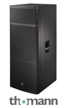

            Electro-Voice (Y)
            Detailed Product Information on EV ELX 215 at www.thomann.de
