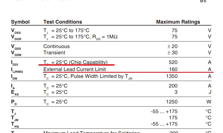

520 amprit
Vs: 520 Amprit
Esmalt postitatud W@ldur poolt Vaata postitustJa nüüd siis ei loe andmelehte? Selektiivne kius, ei muud
ID25 TC = 25C (Chip Capability) 520 A
Linki meelega ei anna, kodutöö.
Mõtlesid seda rida
IDM TC = 25C, Pulse Width Limited by TJM 1350 A
Kumb siis ikkagi ÕIGE vool on

Esmalt postitatud A.R. poolt Vaata postitustKumb siis ikkagi ÕIGE vool on
IL(RMS) External Lead Current Limit 160A
Vs: 520 Amprit
Continuous On-state Drain Current ID25.
This is the maximum current rating for the device at a case temperature (TC) 25oC. It is calculated based on maximum power dissipation, maximum on resistance and temperature dependence of on -resistance. It can be limited by the current handling capacity of leads.
Junction Temperature TJ and TJM.
The junction temperature (JT) range is -55 ~ 150oC in most cases and it is the device’s permissible temperature range within which the device may be operated continuously .The maximum junction temperature (JMT) is 150oC unless otherwise specified (in some cases 175oC). Junction temperature varies electrical parameters of Power MOSFET, for example, at very low temperature (< -55oC), the device can loss its functionality and at very high temperature, the device’s threshold voltage becomes very low and leakage current becomes very high. It also can cause thermal run away within the device at very high value.
Vs: 520 Amprit
Et siis lased amprid läbi, jalg põleb ära.
Sina oled rahulik, see oli ainult jalg - kristall on ju alles.
See jalg tundub ka 160 A jaoks peenevõitu.
Kui koroona kestab siis on aega proovida.
Milline see seda tõelist 500 A läbi laseb?viimati muutis kasutaja A.R.; 25 m 2020, 16:28.

Esmalt postitatud A.R. poolt Vaata postitustSina oled rahulik, see oli ainult jalg - kristall on ju alles.
Vs: 520 Amprit
Esmalt postitatud otsija poolt Vaata postitustTegelikult kui see transs radikal ja selle kaudu jalg ka kenasti jahutatud, siis nii lihtsalt see läbi ei põlegi tegelikult.
Vs: 520 Amprit
Koiva lubatud maksimum temperatuuril 25 kraadi!
Kristalli enda lubatud voolutaluvus ja koiva oma on väga erinevad.
Kui vaja suurt ja julma voolu madalal pingel siis TO263-7 näiteks on palju parem kui suur ja robustsena näiv TO264
Lisaks on suurel kestal ka suurem takistus viikudest kristallini.-superradical-

See jalgade 160A on jah korpuse 250C juures. Suurema vooluga korpuse temperatuur tõuseb. Palju tõuseb, selle sa proovid ise kohe järele.
Esmalt postitatud A.R. poolt Vaata postitustMilline see seda tõelist 500 A läbi laseb?
