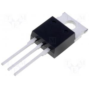

    Selle türistori ma leidsin oomipoest, justkui sama komponent:
    bt136-600e, triac, 600v, 4a, 11ma, to220ab, türistor, bt136600e, bt136, 600e, turistor, thyristor, tiristor
