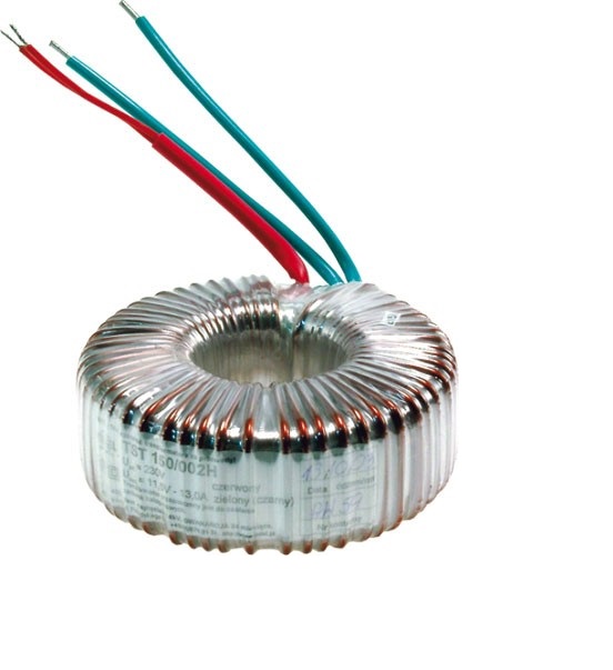

                Kui aga valmis lahendus, siis:
                toroidal, transformer, 250w, 24v, 10.41a, 130, 55mm, indel, toroidtrafo, 250va, tst, 250, 003, trafod, ja, drosselid, 10.41, 230, 24, 250003, 1041a, 1041, tst250, tst250003, toroidalnyiy, transformator, transformers, chokes, transformatoryi, drosseli
