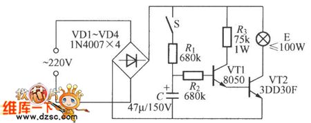

                Hõõglamp oleks 220v ja 40-60W. Tegemist siis tavalise võrguvooluga (vahelduvvool).
                  Vs: Pikalt kustuv hõõglamp
                  The simple fade out/in switch circuit is shown in the figure, usually, the switch S is open, triodes VT1 and VT2 are both blocked, the lamp E is not glowing. When we need the lamp to light, just close S, the 220V AC current is turned into an impulse DC current after rectification, the capacitor C is charged by switch S and resistor R, which makes the voltag
                  (Радиохобби №1 2002г стр. 25)
                  viimasel on heleduse reguleerimine ka
